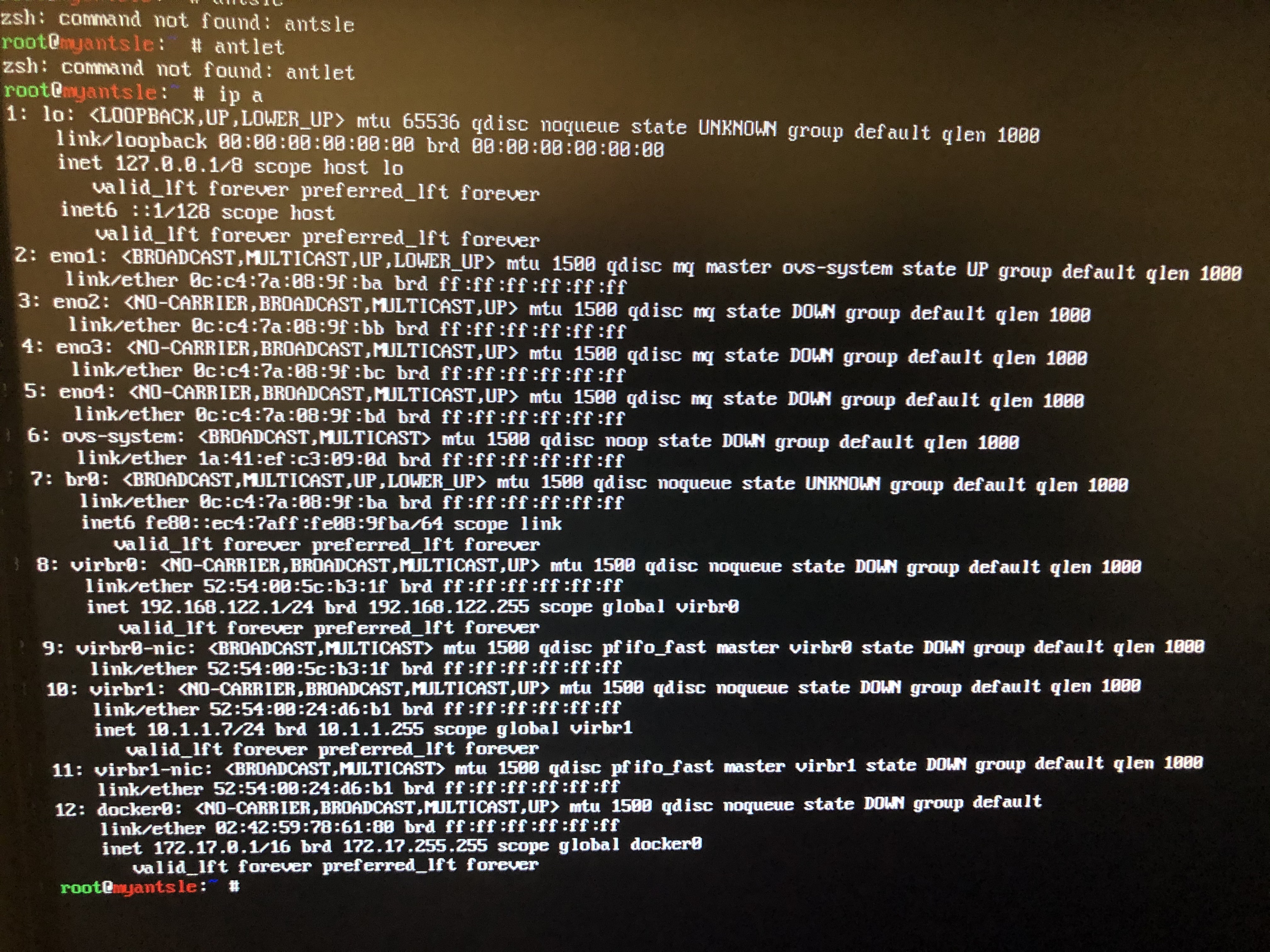

Quote from AndrewTraub on February 13, 2020, 1:10 pmWell, I already have a machine at myantsle.local (which I bought from you guys) so that won't work. My EdgeLinux machine was at the IP 192.168.4.4 before installing EdgeLinux but is not at that address since. And I can't get the serial number since I don't know the IP address to get into andMan.
Quote from mardo.delcid on February 14, 2020, 4:27 pmHi @andrewtraub,
Thanks for your feedback, we'll add a step to name your antsle when installing edgeLinux before releasing the GA version. Right now you will need to login in to your server and run `ip a` to get your current IP.

Quote from AndrewTraub on February 17, 2020, 7:48 amIt was set to 192.168.4.4 but now appears to be 192.168.122.1 if I'm reading this correctly (see screenshot attached). So how do I change the IP back to 192.168.4.4?
