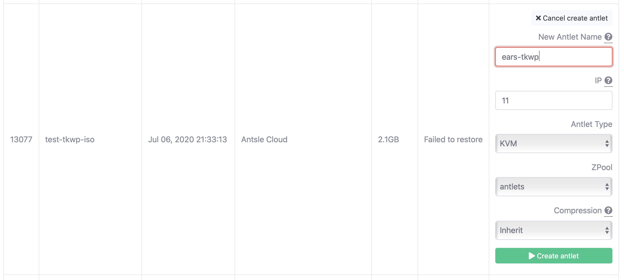

Due to this error, I reinstalled edgeLinux 2.0.  I attempted to restore one of my cloud antlets via the heal antlets function. The function appeared to work; however, it did not show up on my antlets screen. So I went back and retried (see screenshot1) and got the error shown (see screenshot2)
