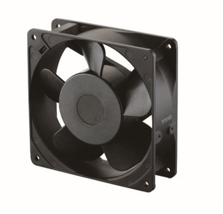

I had the same issue with 10GB interfaces on both of my Antsle One XD. I am running Proxmox on both of them and getting the following error on Proxmox console :
ixgbe 0000:03:00.1 eno4: Network adapter has been stopped because it has over heated.
The interface is automatically shut down to ensure hardware protection.
To fix the problem, I have installed one fan on the top of both Antsle with the fan pushing air upward. Running like this for a while and never had problem anymore.
The fan used is the following (110 volts) : https://nmbtc.com/parts/4715ms-12t-b20-a00_60hz/
Solution is cheaper than buying a new case and fans are running quietly.
