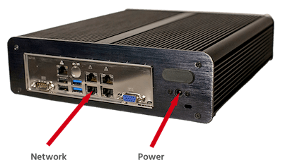

First connect the network. Use either the network cable that came with the antsle or your own cable. The cable we delivered is Cat 5e, up to 100 Mbit/s. If you need more (depending on your router), use your own cable. The antsle can handle up to 1 Gbit/s.
IMPORTANT: Please use the correct network port! See image below.
Connect the other end of the network cable to a LAN port of your router.
Connect the 12V jack of the power adapter to your antsle, see image.
Connect the power adapter into a wall outlet.
